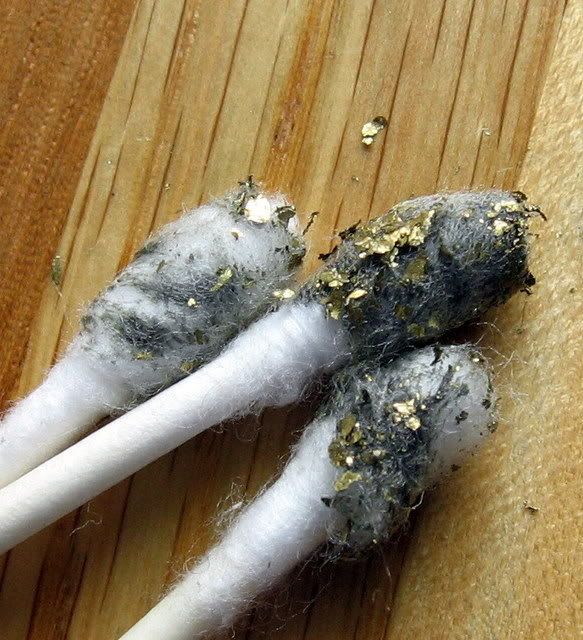

Every once and a while, I read over a thread about whether or not routine cleaning should include a full slide disassembly. I hadn't done one on my PM9 in about 500 rounds, so I decided to do a full strip. Below is a picture of brass flakes I found in the striker channel. Shown below are three Q-tips. It took an additional three Q-tips before I got all the flakes out.
I use mainly WB FMJ.
On the basis of my finding, I plan to do a full strip AT LEAST every 500 rounds.

J, I was just wondering if you ever clean the striker channel with non-chlorinated brake cleaner after every range session? By doing so, I believe that you could avoid doing the full strip of the upper more than once a year.
I don't see how blowing anything through the blow hole, including break cleaner, can get rid of brass flakes without opening the striker channel. The little blow out hole will just push the flakes around inside the channel since there's no place for the flakes to exit the channel.
