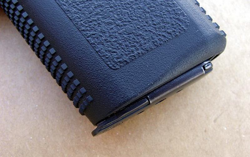

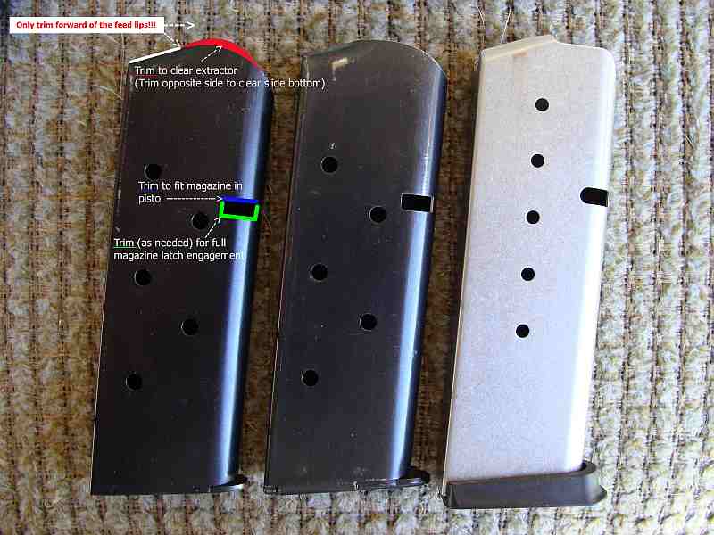

Any CW45/P45 owners interested in a flush fit magazine option?

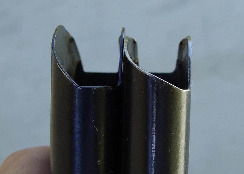

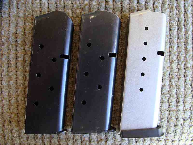

The base mag is less expensive than Kahr OEM magazines, but it's very good quality. The magazine will require some modifications, but they can be done with a file or Dremel tool.

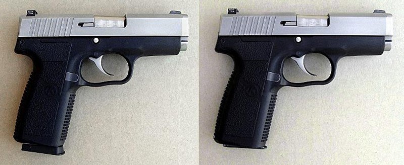

It works flawlessly for me as a 6 round magazine (using a Kahr follower and spring) with proper "lock back" function: YouTube - Kahr CW45: flush fit, six round magazine.
It will work as a 7 round magazine (using the follower and spring that comes in it), but will not lock the slide back. Regardless of this, I think it very usable: especially if you carry without a spare mag: YouTube - Kahr CW45: flush fit 7 round magazine.

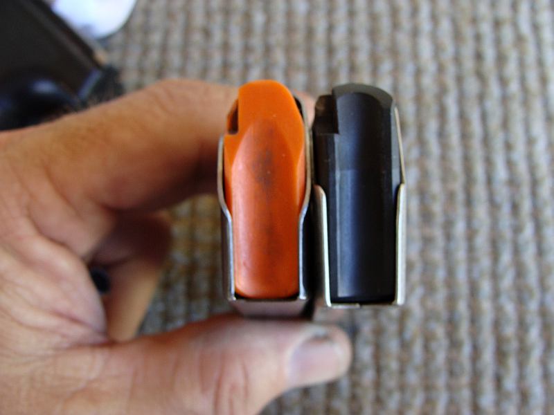

Note: Though I prefer using the Kahr follower and spring, camsden1 reports this mod can be done to a Mec-Gar 6rd. Officer's magazine (MGCO4506) to include locking back with the Mec-Gar components (follower and spring) installed.
Again, this is how I did it, not a "how to": proceed with any modifications at your own risk.

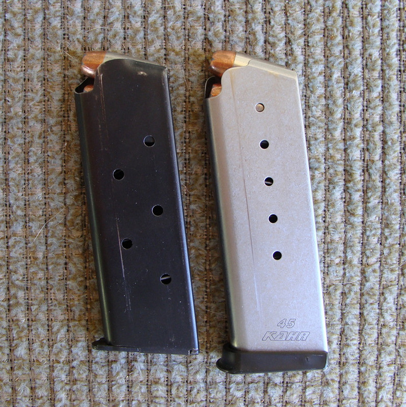

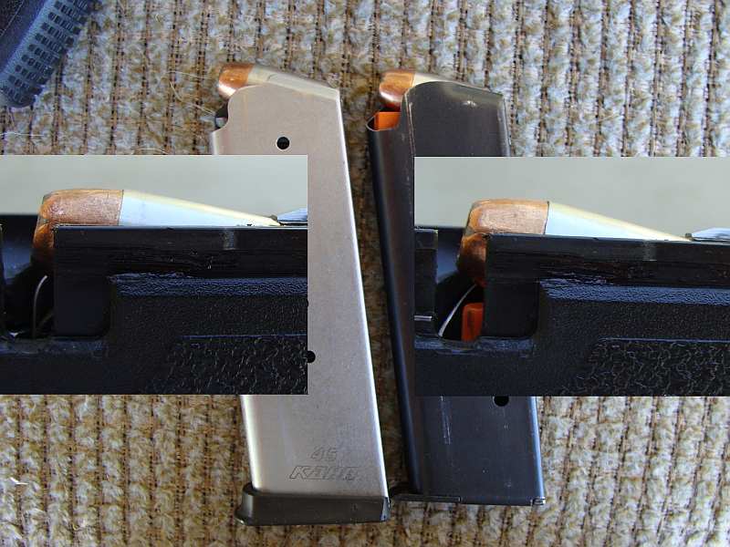

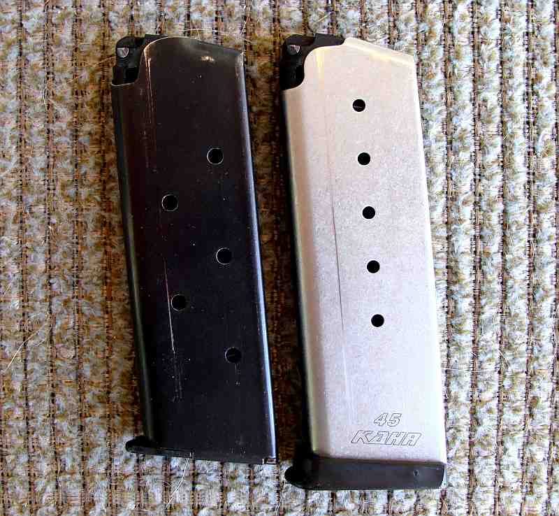

Here's a comparison shot:
Mec-Gar magazine on the left (note style of follower);
